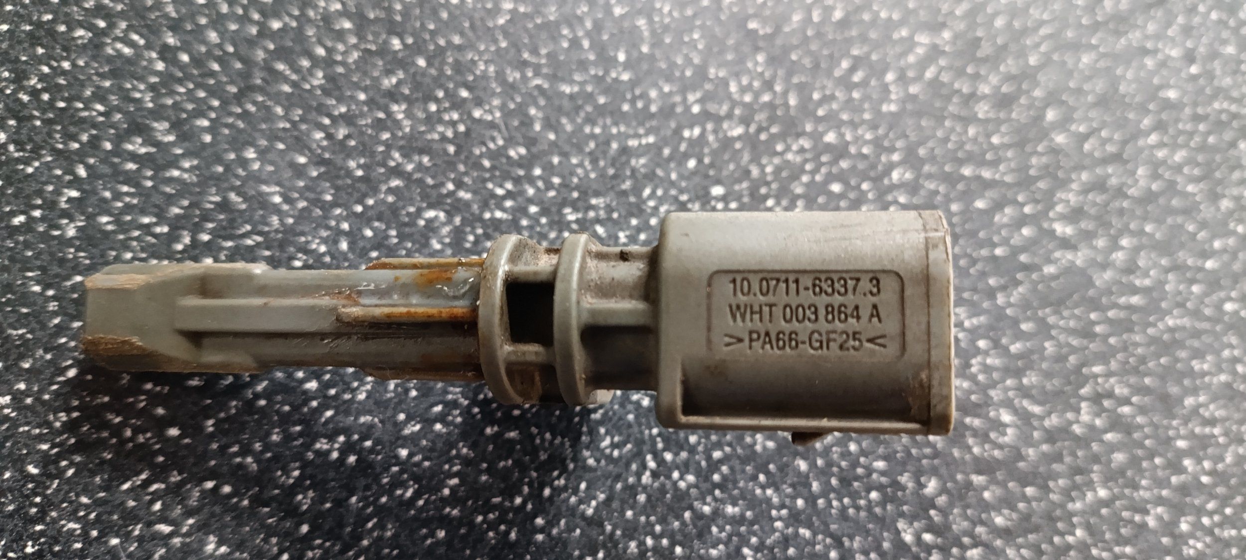

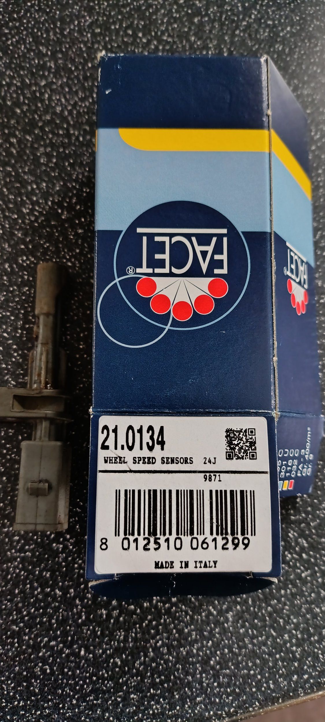

Well after more diagnostics I did indeed narrow it down to the rear right sensor it was registering 0 speed when the other 3 were showing the same speed that I was traveling. So I bought a new Facet sensor for £19 , removing the old one was awkward, removing the bolt was easy but pulling out the new sensor that has been there for 10 years took some time, it can't be twisted so some gentle levering and pulling is required until it's half way out then it can be twisted gently and with the help of wd40 it came out. The new one is a tight fit but eventually I fitted it and so far all is well, I've attached some pics of the old sensor and the new facet part number for reference, the
sensor needs to be the correct one depending on whether the car has adaptive cruise or not.
Well after more diagnostics I did indeed narrow it down to the rear right sensor it was registering 0 speed when the other 3 were showing the same speed that I was traveling. So I bought a new Facet sensor for £19 , removing the old one was awkward, removing the bolt was easy but pulling out the new sensor that has been there for 10 years took some time, it can't be twisted so some gentle levering and pulling is required until it's half way out then it can be twisted gently and with the help of wd40 it came out. The new one is a tight fit but eventually I fitted it and so far all is well, I've attached some pics of the old sensor and the new facet part number for reference, the View attachment 47507 View attachment 47508 sensor needs to be the correct one depending on whether the car has adaptive cruise or not.
All of the facelift Leon's have the bidirectional sensors installed
Prefacelift is dependent on if ACC is installed or not
