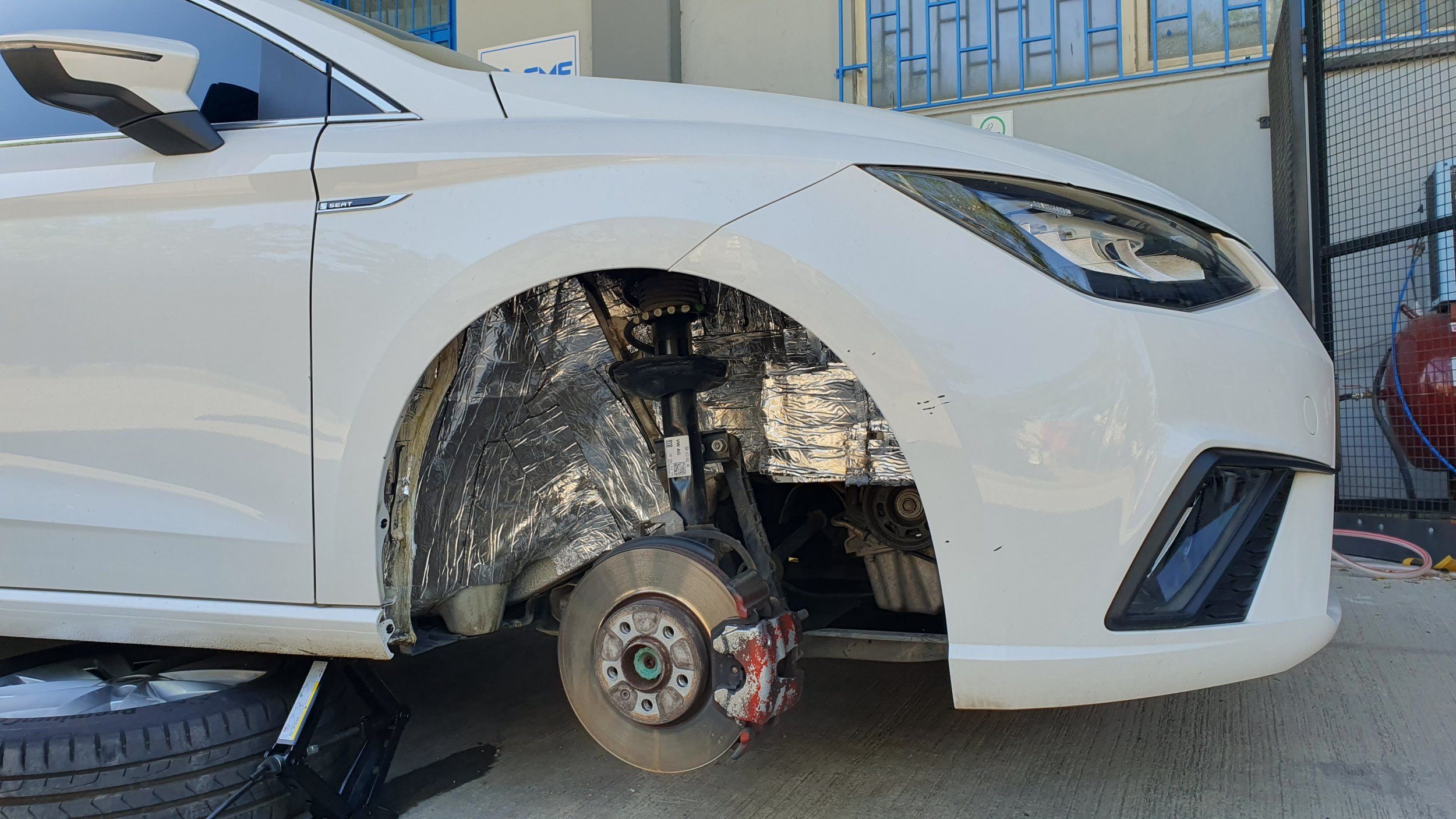

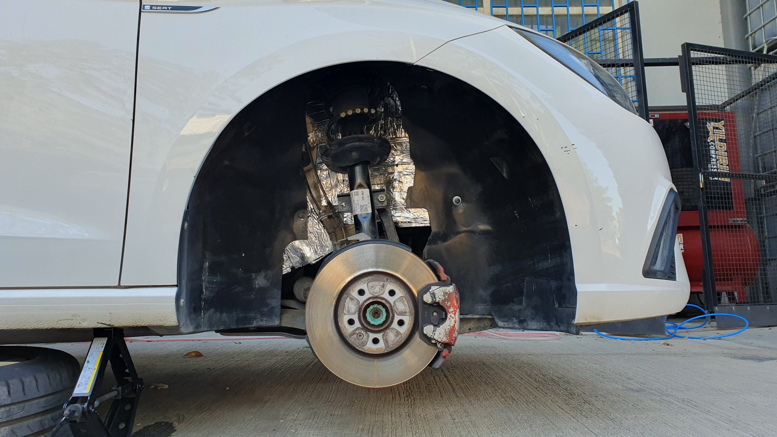

Hello IBIZA enthusiasts,
As I mentioned before, I'm back at it with soundproofing.
Since I'm still relatively new to working on this particular vehicle, the disassembly and reassembly process took a bit longer than usual, and I was only able to complete the front left side.
As always, I started by applying vibration-damping materials, followed by closed-cell foam sheets to absorb sound.
On top of the wheel well liner, I applied a different, thicker, and heavier material called a sound barrier.
Putting everything back together was a bit of a challenge after all that, but I'm happy with the results.

i can't make a clear comment about the sound because I only made it to 1 tire, but I can say that there is a decrease
there is no specific place, I tried to glue it completely to all surfaces. it is necessary to pay attention to some surfaces in order not to have difficulties when installing which ı had experienced.

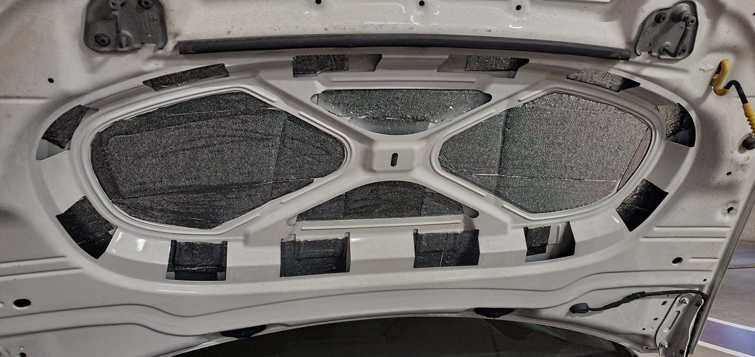

What about the deadening on the hood? Did that help?

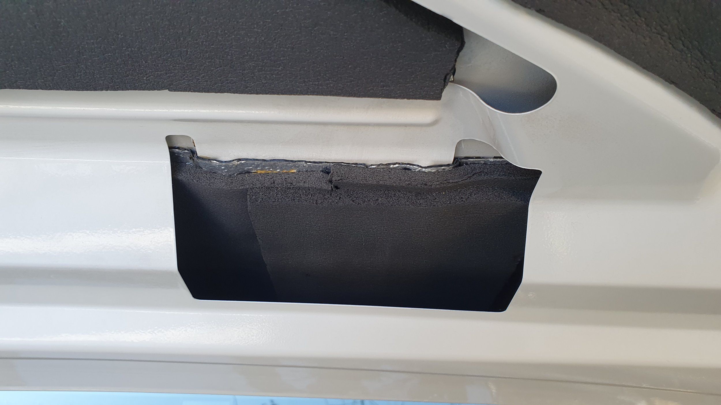

Absolutely YES, I tried to fill every gap that my hand reached.
After gluing a layer of butyl, I glued closed cell sponges on top of each other to fill the entire gap.
I finished it with an OEM under-hood insulator to make it look visually good.
The engine noise has decreased significantly. I believe that it will be a much higher level with higher quality materials
