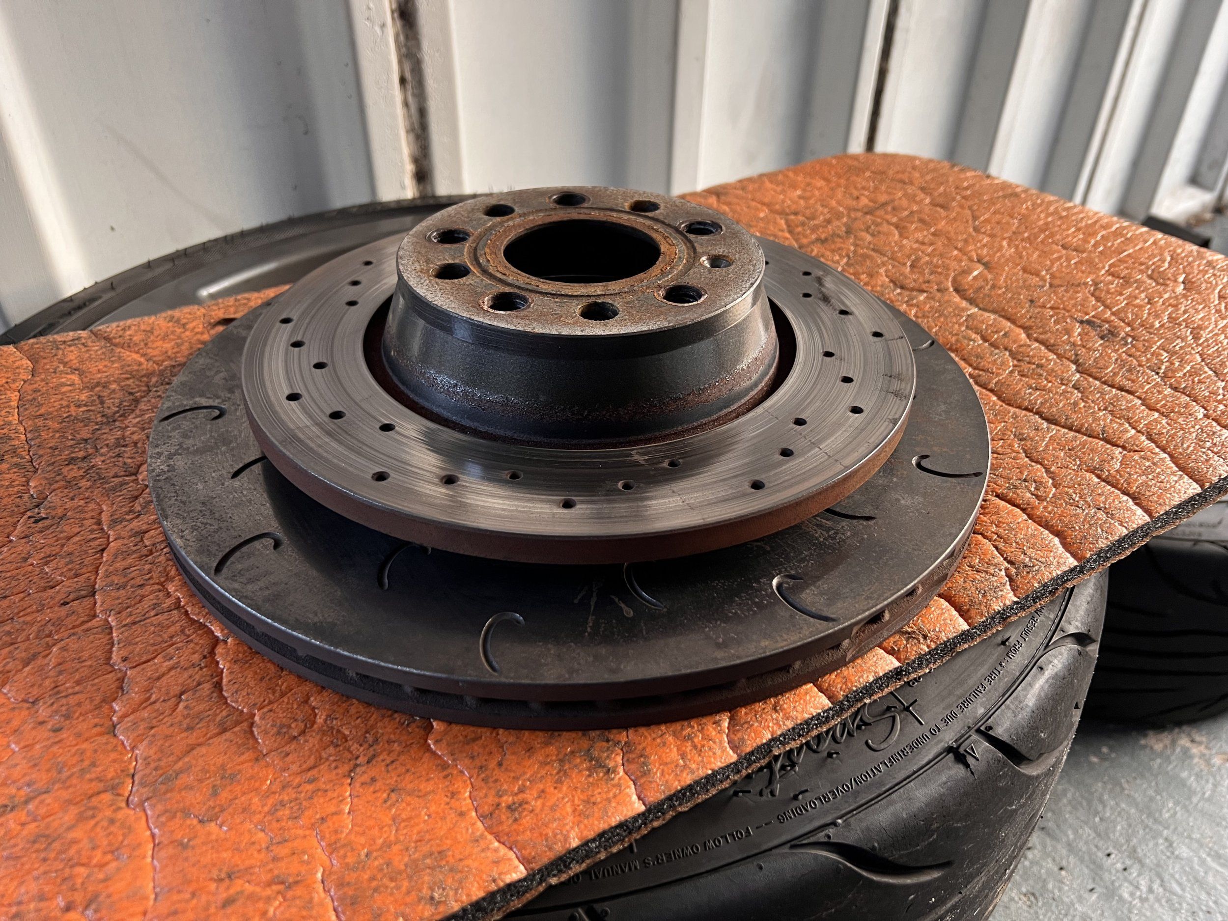

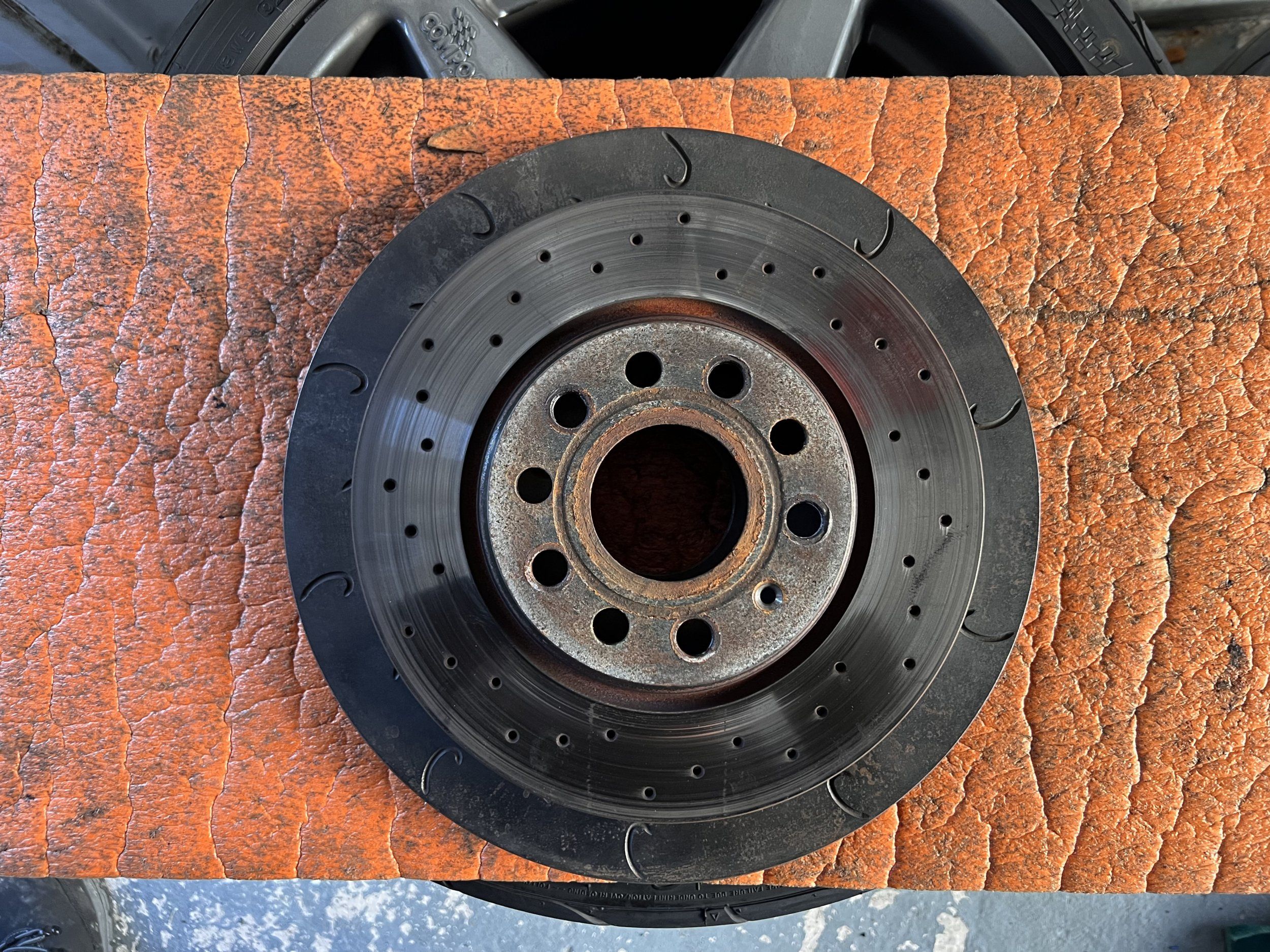

You can use: Audi S6 & S7 discs even the Rs7 Wavy discs if you want to be fancy but I picked up some second-hand lightly used 356x22mm CHook discs to use.
OE Part no: 4H0615601P

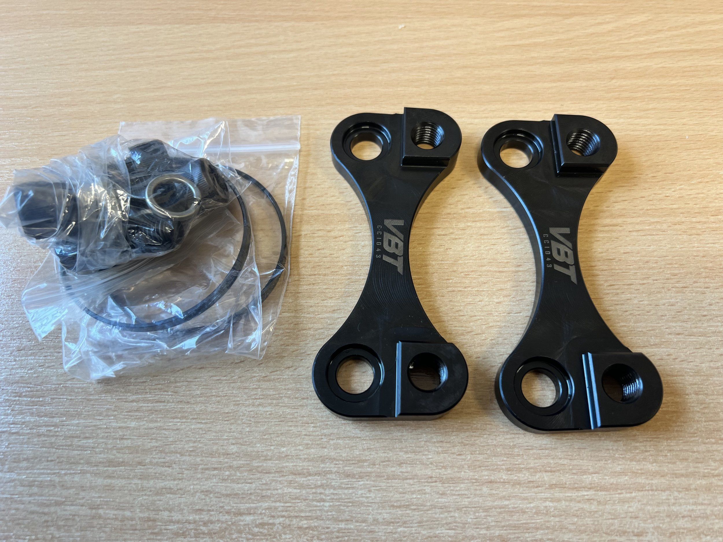

You can purchase the adaptor kit from VagBremTechnic Here.
You can also upgrade this kit on the VBT website to include the discs/pads etc should you wish.

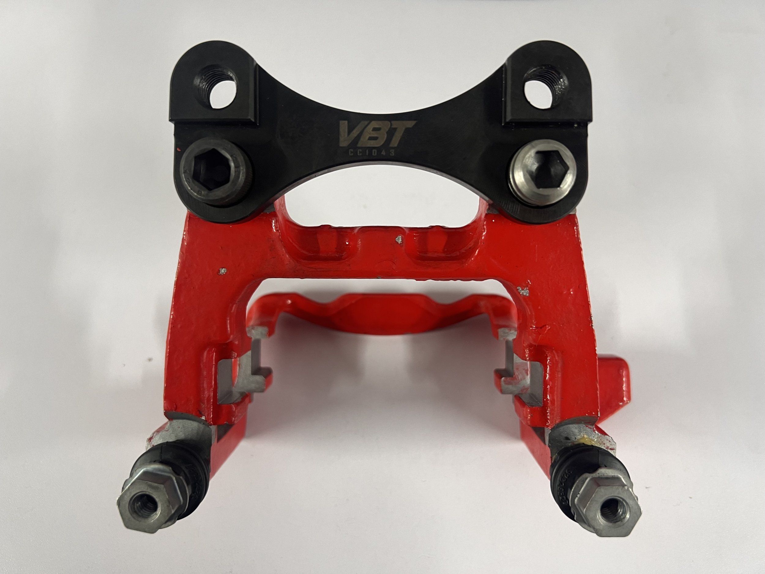

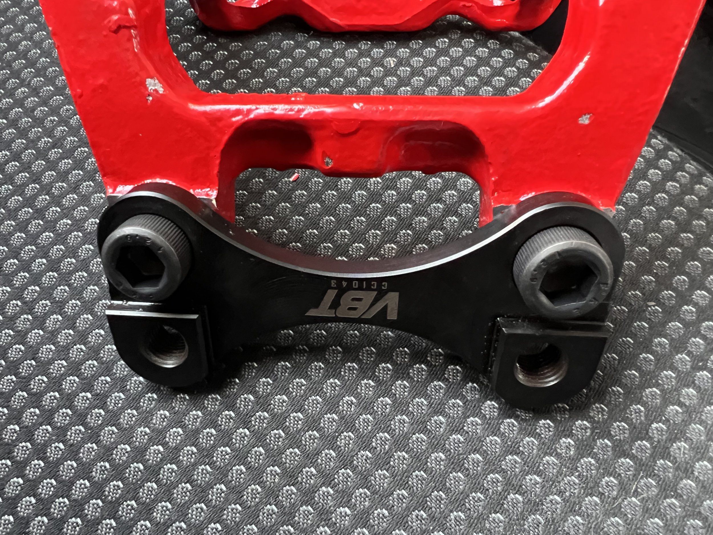

The kit that I got consisted of;
4x Caliper to carrier bolts
4x Spring washers for calliper to carrier bolts
2x Centre bore adapters for the discs
They list this kit only for the MQB/e-brake only but to get this kit to work you have to make some modifications to the lower bolt that secures the carrier to the adaptor.

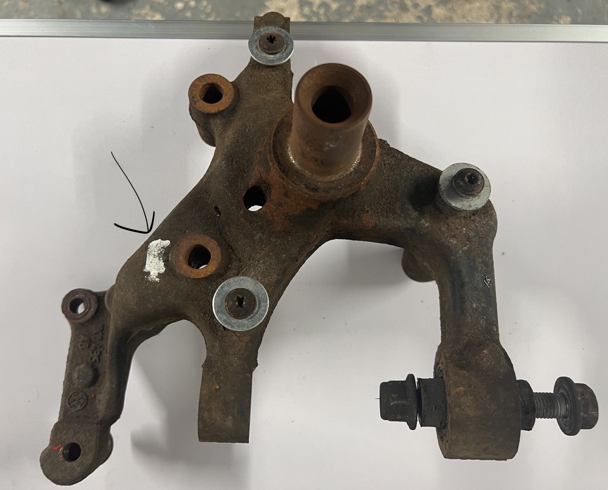

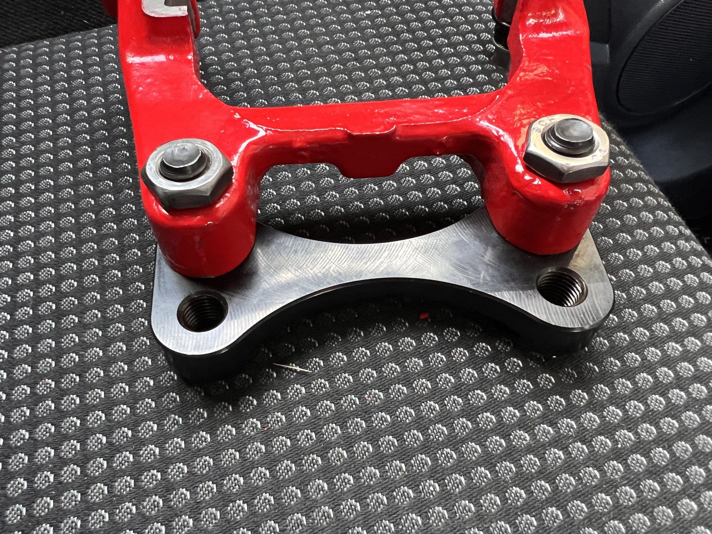

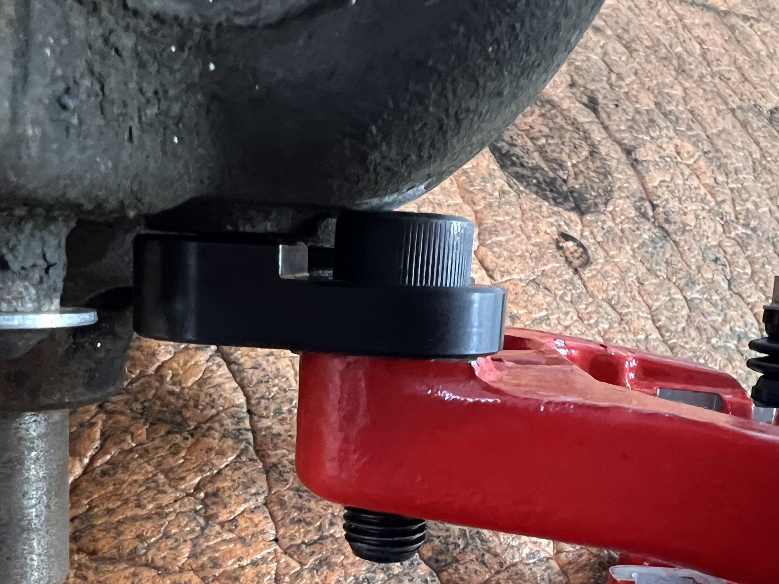

I have marked on the below picture where the lower cap head bolt that comes with the VBT kit makes contact with the hub.
You could shave where the white mark is but I did not want to potentially weaken the rear hub with it being on the bend another option was to modify the bracket but I did not want to potentially weaken that too. This is the way I did it but you can choose to do it another way if you wish.
There is a local machine shop that I use for various stuff so I took the bracket, bolts and hub to see what they come up with and £20 later, I am very happy with the results.

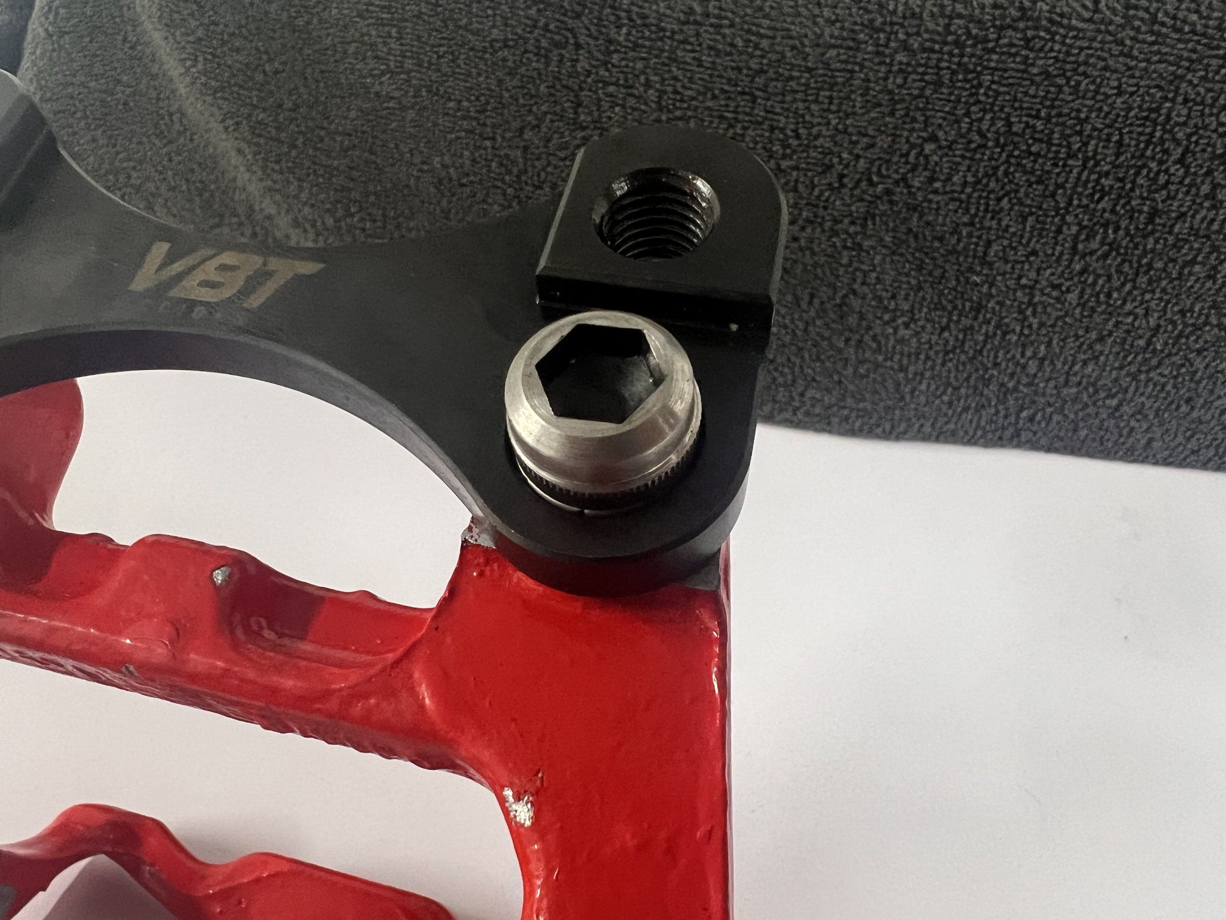

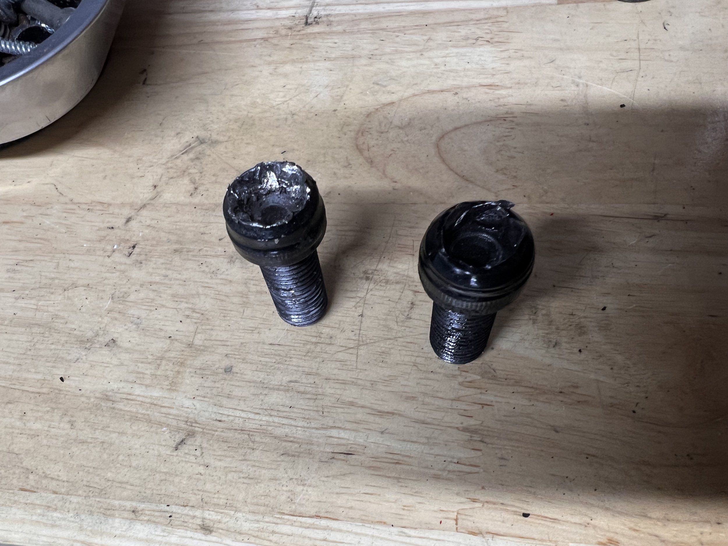

They modified one of the cap head bolts by shortening the top and also added a large chamfered edge while keeping the integrity of the bolt intact.
Looking at the photos below you can see the modified bolt to the right and the standard one to the left. (I need to paint the modified one so it does not rust).
*** EDIT ***
The machined bolts did not work because as soon as you put any torque on them they mush up. I did suspect they would but hoped they would not. After many swear words I managed to extract both of the machined bolts and threw them across the garage in disgust!!!
Back to the drawing board with the bolt situation and what I come up with should have been the first iteration really.

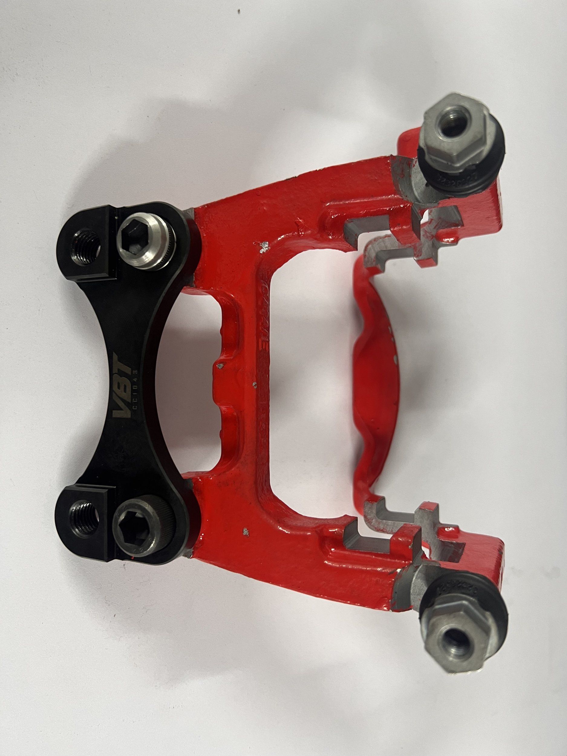

If I removed the spring washer that comes with the VBT kit it gives me an extra 2 mm of room to play with when the bolt is torqued up.
That gives us another problem though as we have no spring washer to stop it from undoing itself.
The solution was to get some m12x1.5 12.9 tensile strength 35mm cap head bolts and some half nuts from the local nuts and bolts shop. I apply some Loctite to the thread of the bolts and added the nut on the other end for added tightness.
See below how close it is to not using the spring washer and using the standard bolt which was not shaven down at this point. This now means that we have to take approx 1mm off the top of the lower cap head bolt to clear the rear hub. I did this with my die grinder pretty quickly and painted it up.

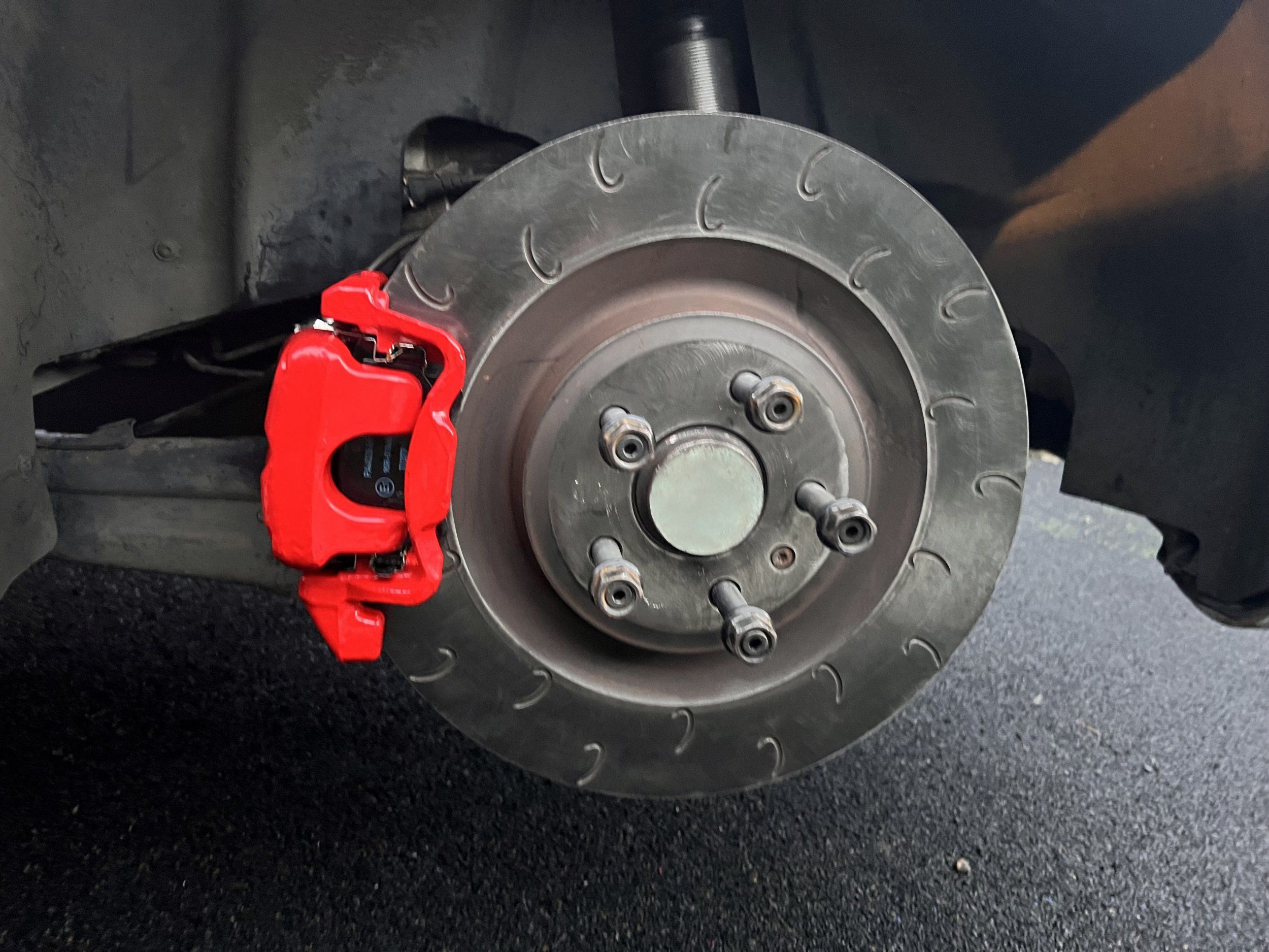

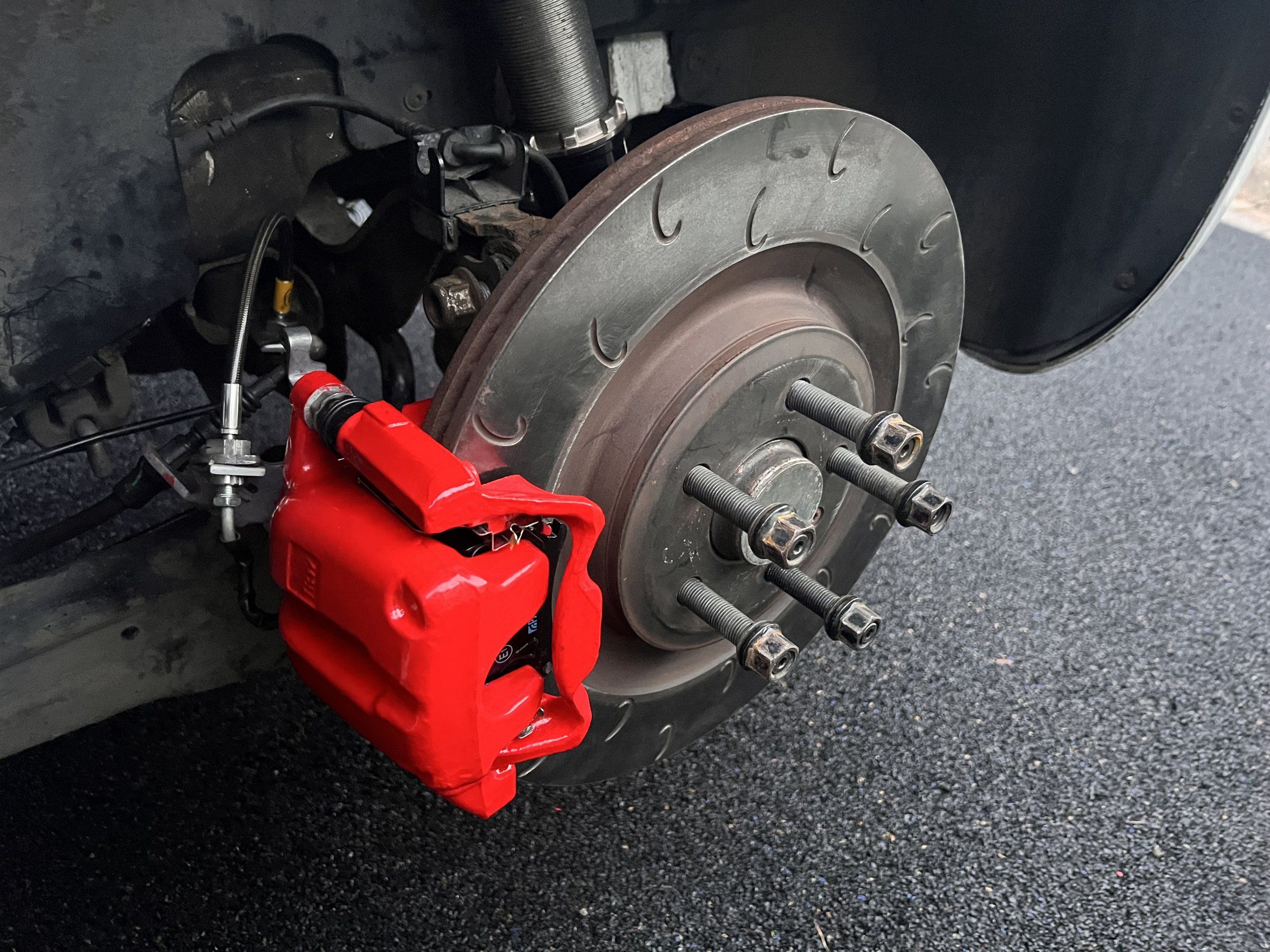

With it all bolting up on my test bench it was time to actually try and fit it to my K1 to see if the theory would pay off.

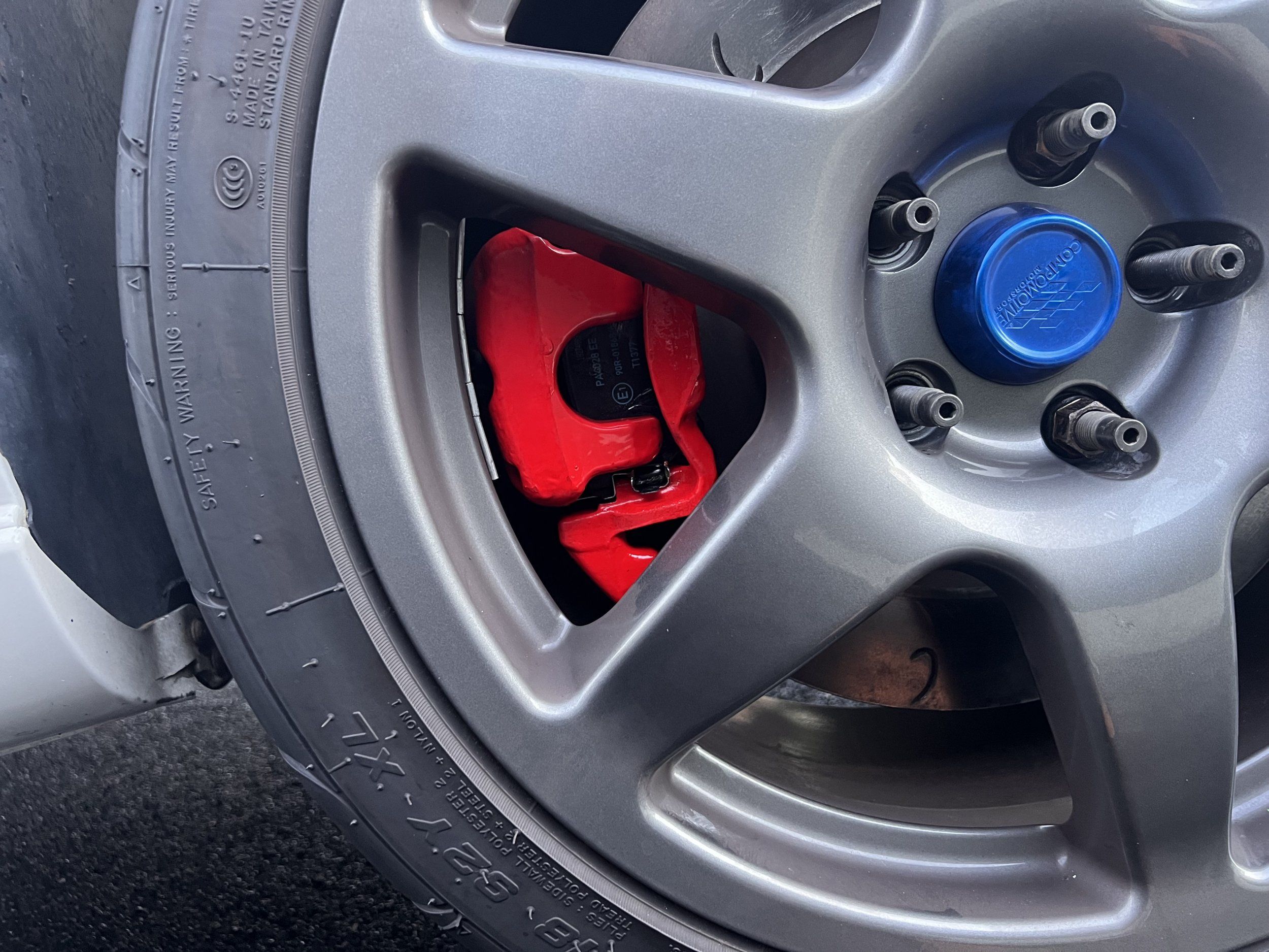

The callipers are a tight fit on my Comp's but I think they sit rather well IMO!
As you can see they bolted up perfectly and look like dinner plates compared to the standard rear discs I had on my K1 lol!!

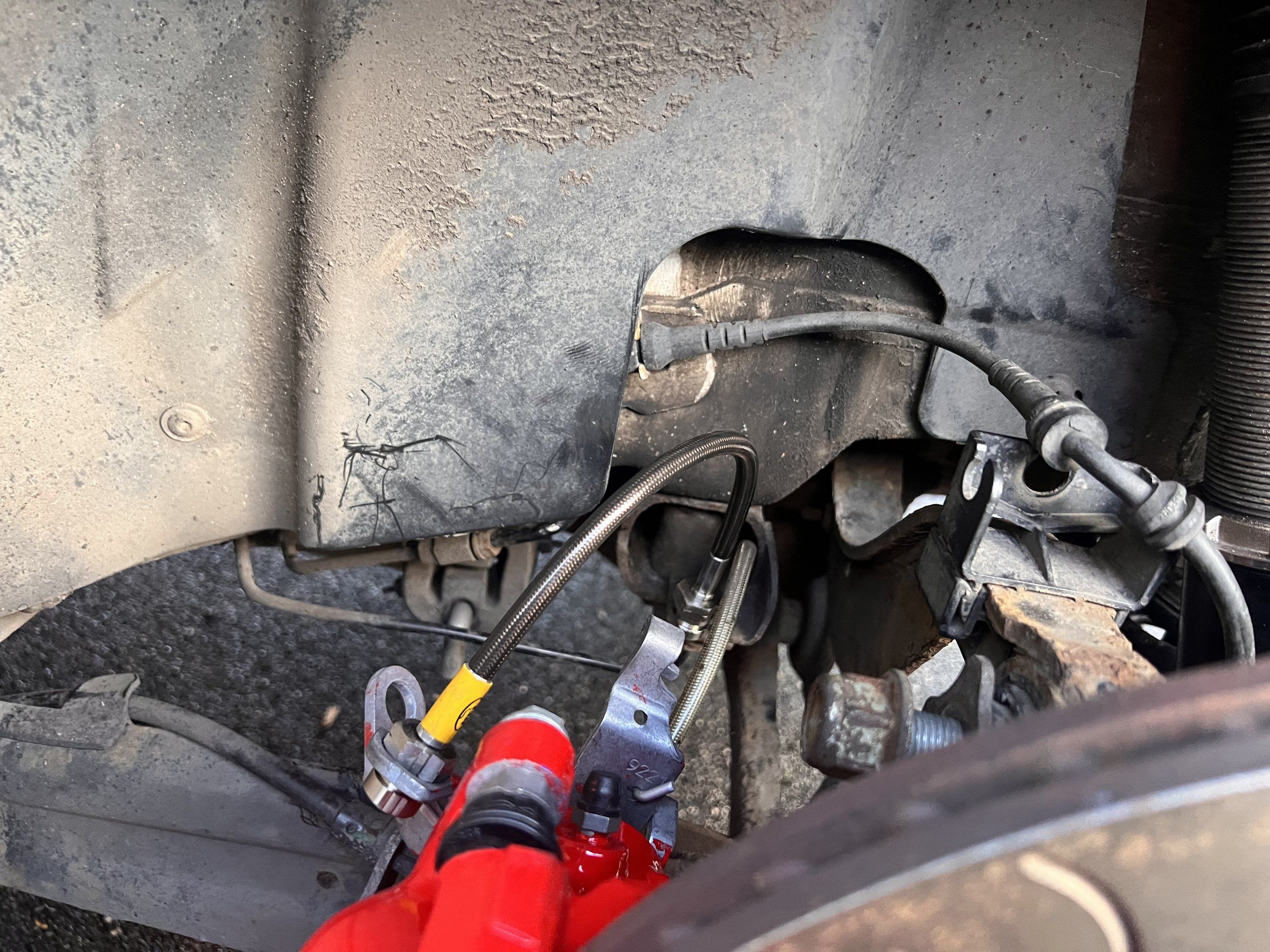

Onto the brake lines - I ordered some standard HEL replacements for my K1 and they seem to be a little tight for my liking.
I spoke to the lads over at AKS tuning and they have supplied me with a 230mm HEL line which fits perfectly!
Everything else bolts up like normal such as the brake lines and handbrake cable.

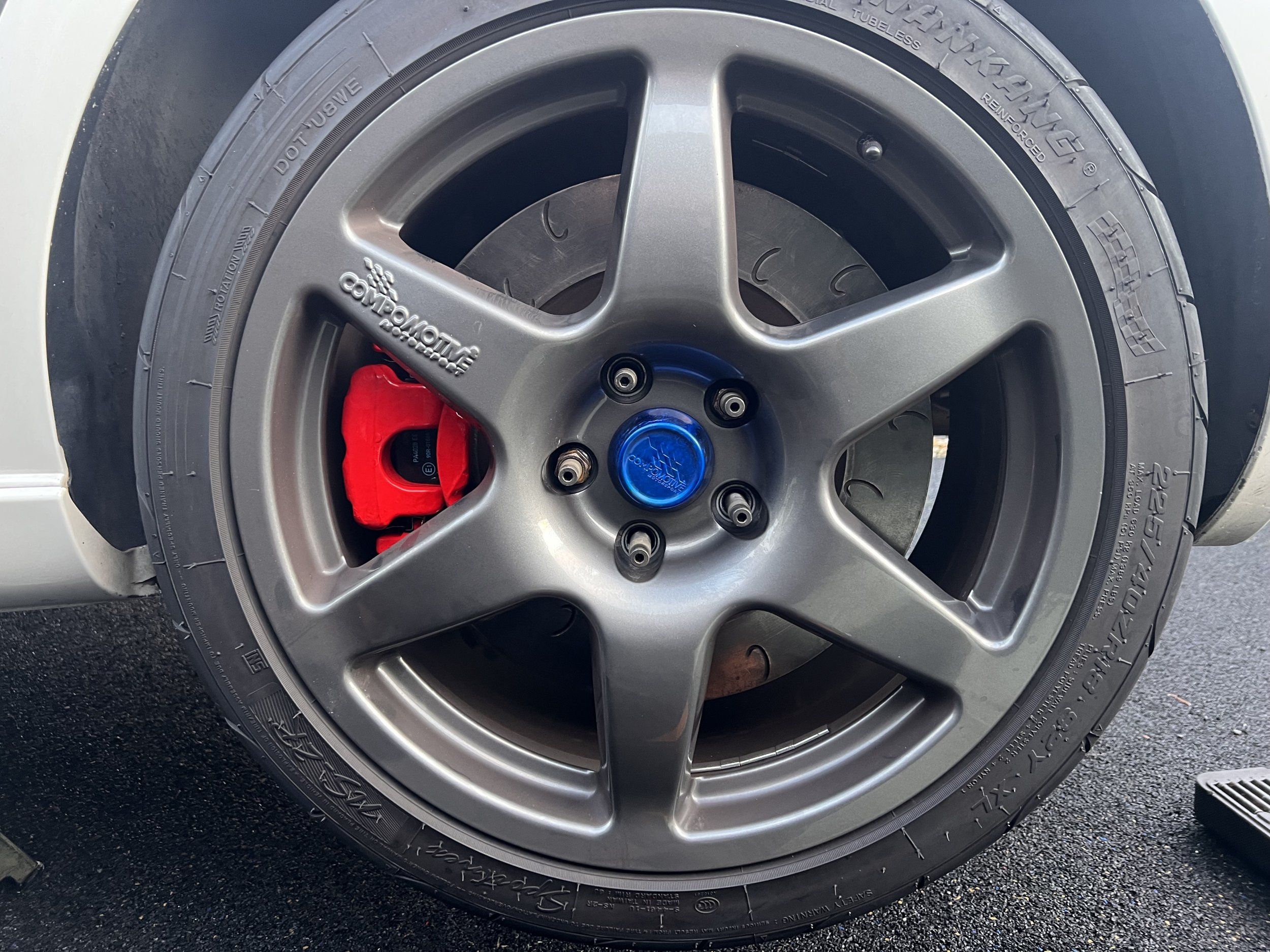

Cheeky pic of my K1 with everything all buttoned up.

A little update on this rear brake setup.
I did a track day at Oulton on the 10th of December and the car felt really good when under braking. The car seemed to squat into the ground rather than diving like it would normally do.
All in all I think it's a well worthwhile upgrade if you have big stoppers on the front or track your car.
