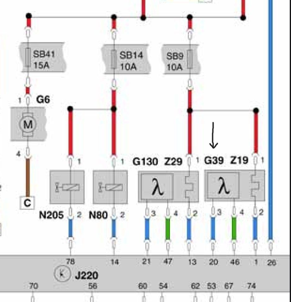

Hi All. In the 18 years we have had our Ibiza the engine management light has probably been on for 17 of them lol!
The fault code is 17524. The fault clears but comes back on next startup. New Lambda sensor didn't cure it. Replaced fuse 9 and still comes up. Now looking to trace wiring. Has anyone got wiring diagrams for AZL engine Ibiza please?

I have a seat ibiza 6l of different engine subtype, namely AUB. I am experiencing a pre cat oxygen sensor problem where I have changed the sensor recently but the problem persists.
The diagram from the sensor to the fuse box and ECU was hard to find but I recently got it. I have marked the pre -cat oxygen sensor with an arrow.
Hope that helps
