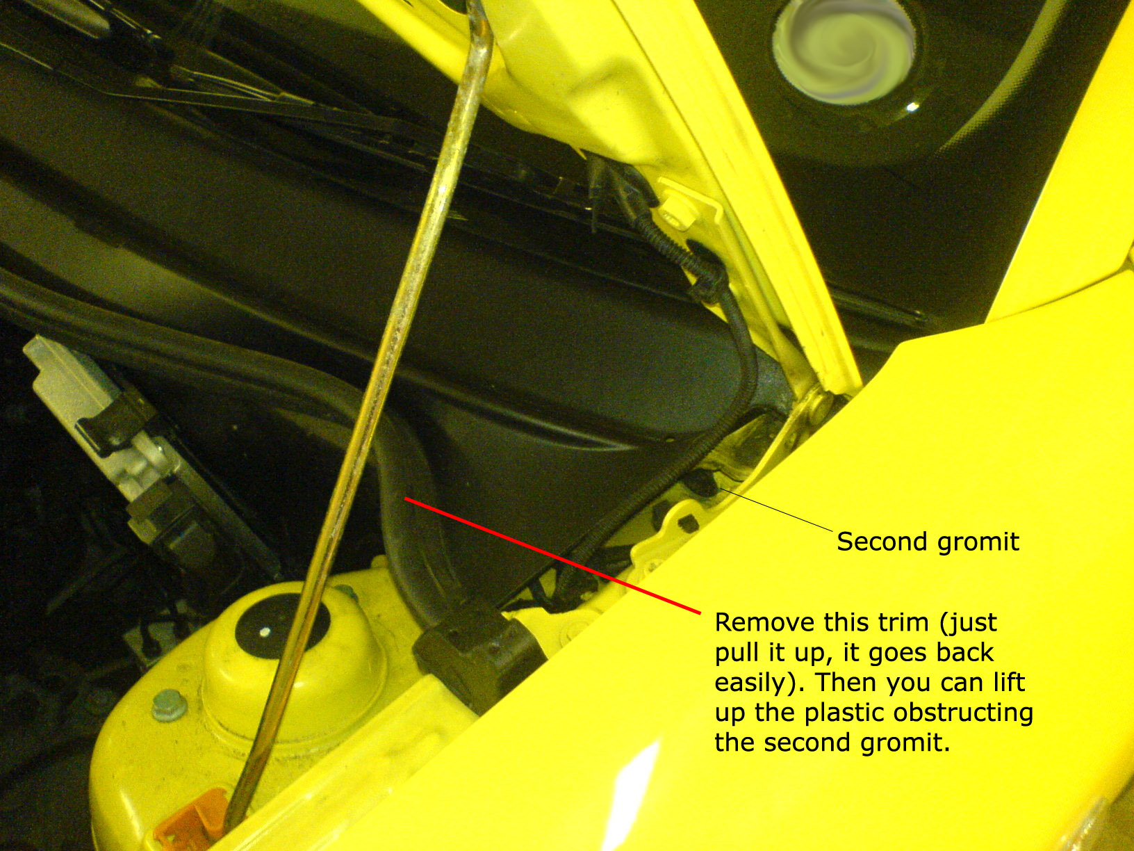

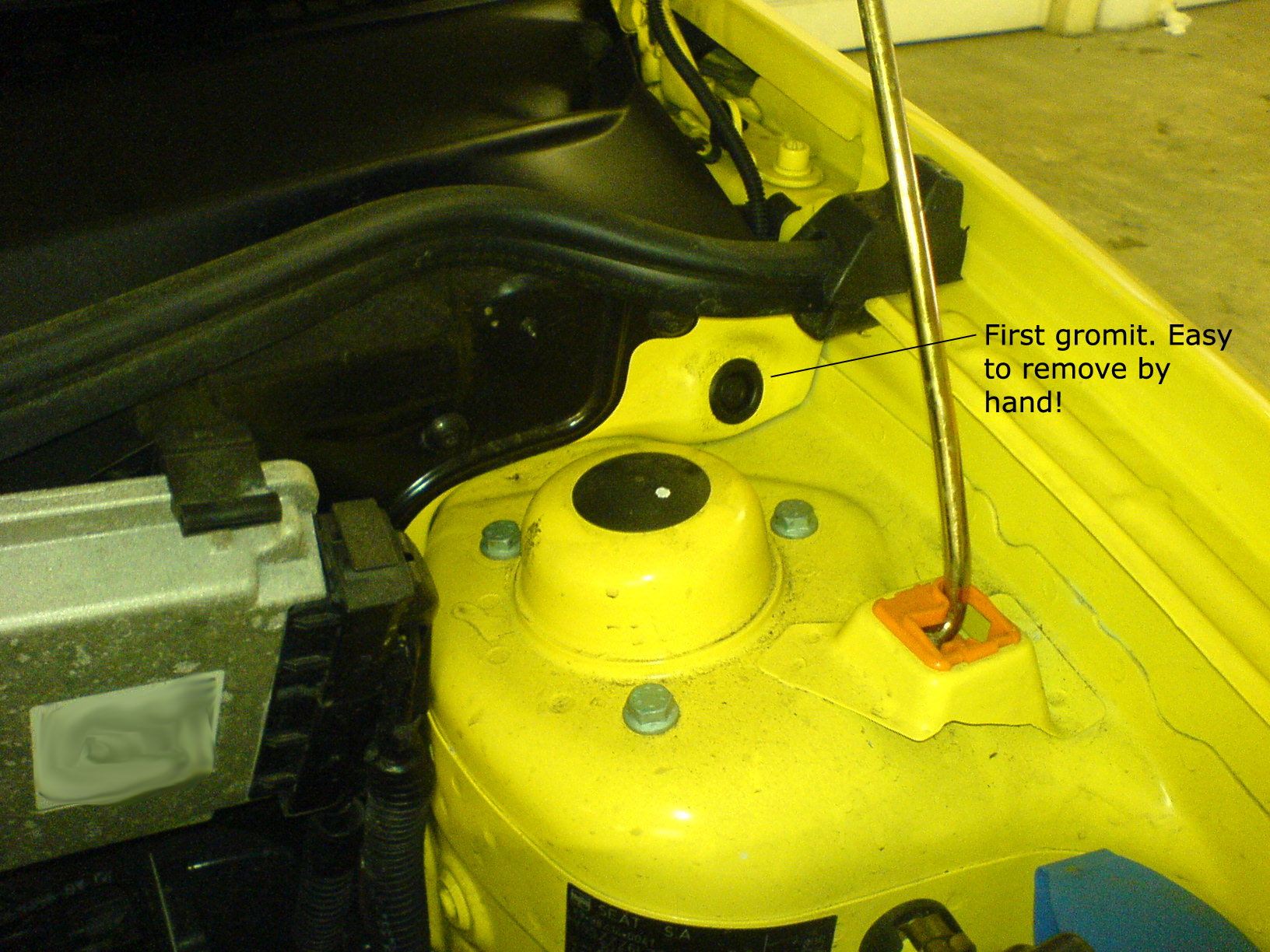

I've uploaded a few photos showing where to find the gromits.

It's a fairly easy job, but here's how I did it, just for fun...
1) Remove the first gromit.
2) Remove the trim (see image2), to gain access to gromit 2.
3) Open the glovebox, and remove all the Torx screws you can see, and remove the upper part of the glove compartment (as if to gain access to the airbag). Don't pull it away too hard, as the wires from the airbag on/off switch aren't all that long. This gives you easier access to where the wires will come through.
4) Feed your wire(s) through the two holes. You may find the second hole annoying as there is some material in the way. I used a screwdriver to push it out the way a bit whilst I fed the wires through.
5) Sorted!

I used the grommit in Dave's first photo. I am going to assume that you are planning to put either a 12v socket in the boot or a asupply for an Amp.

I actually used the grommit, just made a hole slightly smaller than cable in it and pushed cable through them.
Thats because only because I don't plan to take it out again. It also mean the cable is protected from metalwork and only requires minimal sealing afterwards.
