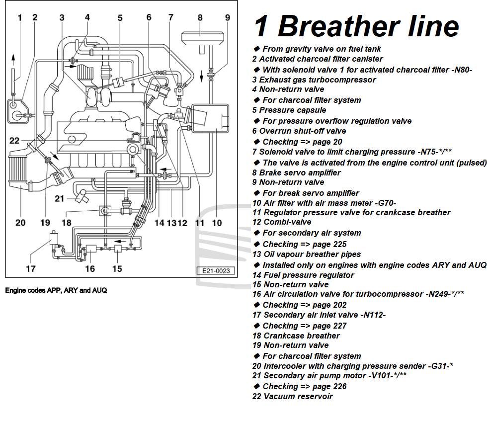

Looking at the logs the boost (actual) is following the boost (requested) pretty closely. Intake air temps look good. Have you checked all the connections to the N75 valve for leaks? Also check the electrical connections to it. Item 7

Sorry, I meant just take the connector off, check for corrosion inside or any loose wires. I think the valve itself is working ok as your boost pressure follows the requested, but if it's only an intermittant problem then could be related to vibration or heat etc. Is the car on a standard map or remapped?
