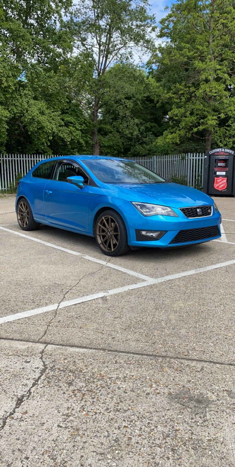

Morning all!
I have the 2016 1.4TSI FR and i’m wanting to up the power! Has anyone done much to their 1.4? I have a forge intake currently fitted and that is all. Any suggestions i’m all ears. Not particularly just wanting a stage 1 flash tune, thinking more like upgrade some internals and do rolling map. TIA!
