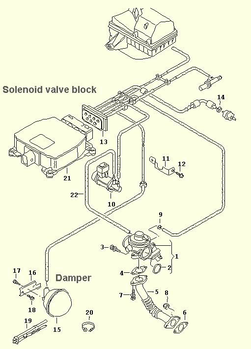

As you know I changed my IC with bigger and I got a big lag. After a remapp it was a little bit better but I wasn't sattysfied. Now I decided to put back the old original Fabia RS .IC And it's the same. Car pulls from 3000 rpm. I don't know what it is. I can hear turbo start sppining at 1500rpm but nothings happens. I checked the pressure sensor and I think it's ok. Even cleaned and closed the EGR valve. On the dyno it's claear that I lost the torque. The torque rise like power. I have 158 HP on 3930 rpm and 295NM at 3700. Before torque was 340NM an 2200 rpm. I have no leak. What should i check next???

THANKS GOD problem solved. The little part of damper half broke where is connected pipe from solenoid valve block to damper. And there was no vacuum. I started checking all pipes and pulled hard this pipe and it broke. When I sealed the pipe car started to pull from 2000 rpm :D. Noe I have to buy new damper (thank god it's not expensive).

N75
Damper, escuse my poor english but what do you meanwith damper ?
What solenoide valve ?The N75 ?
