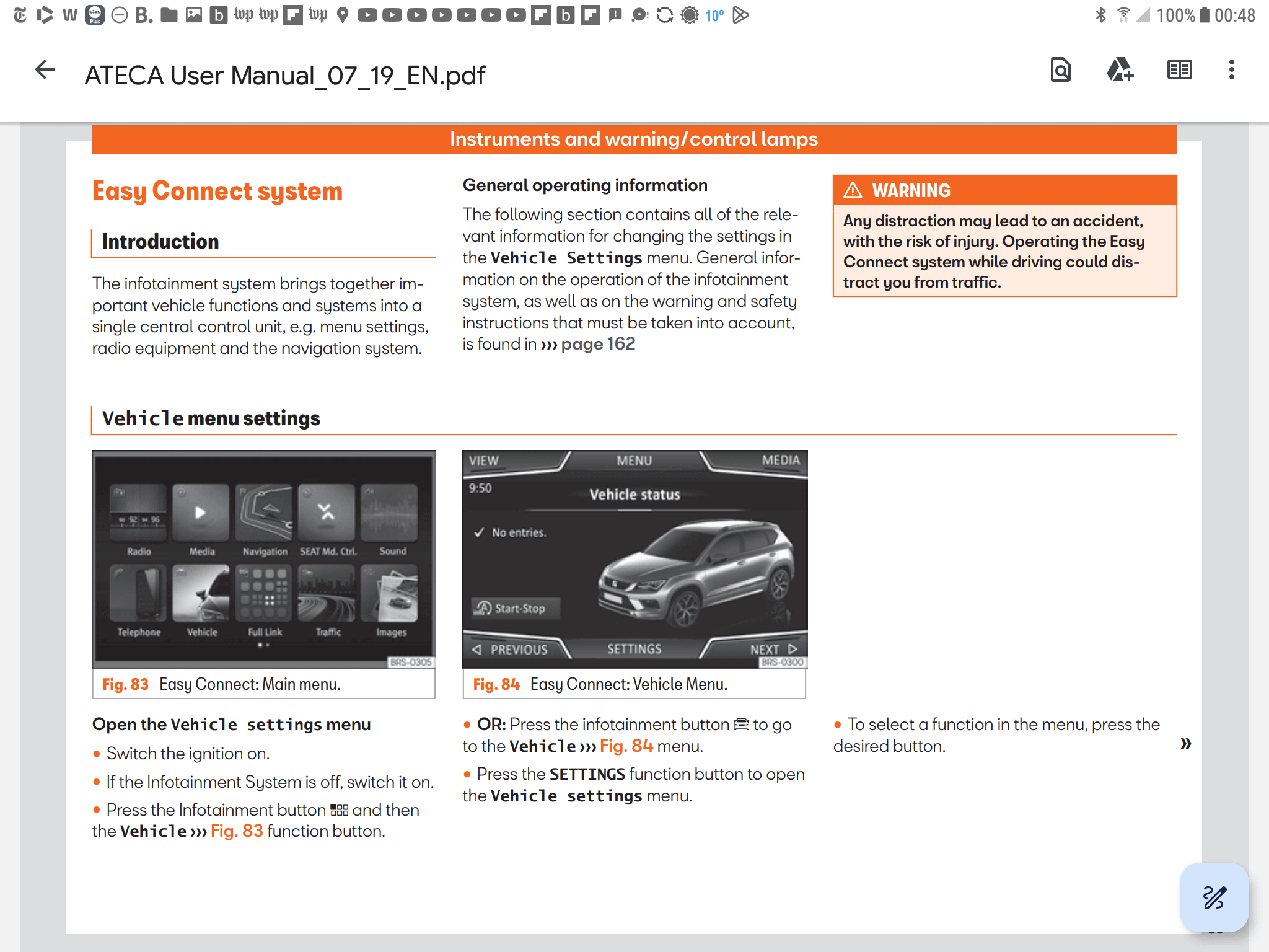

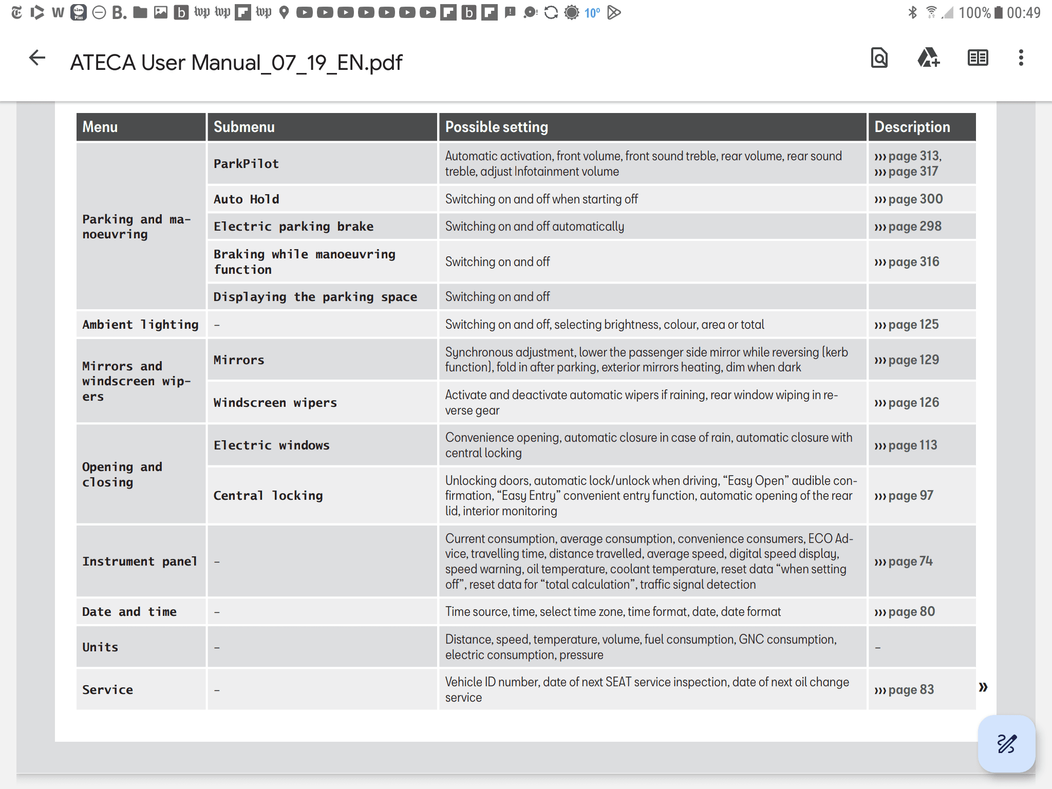

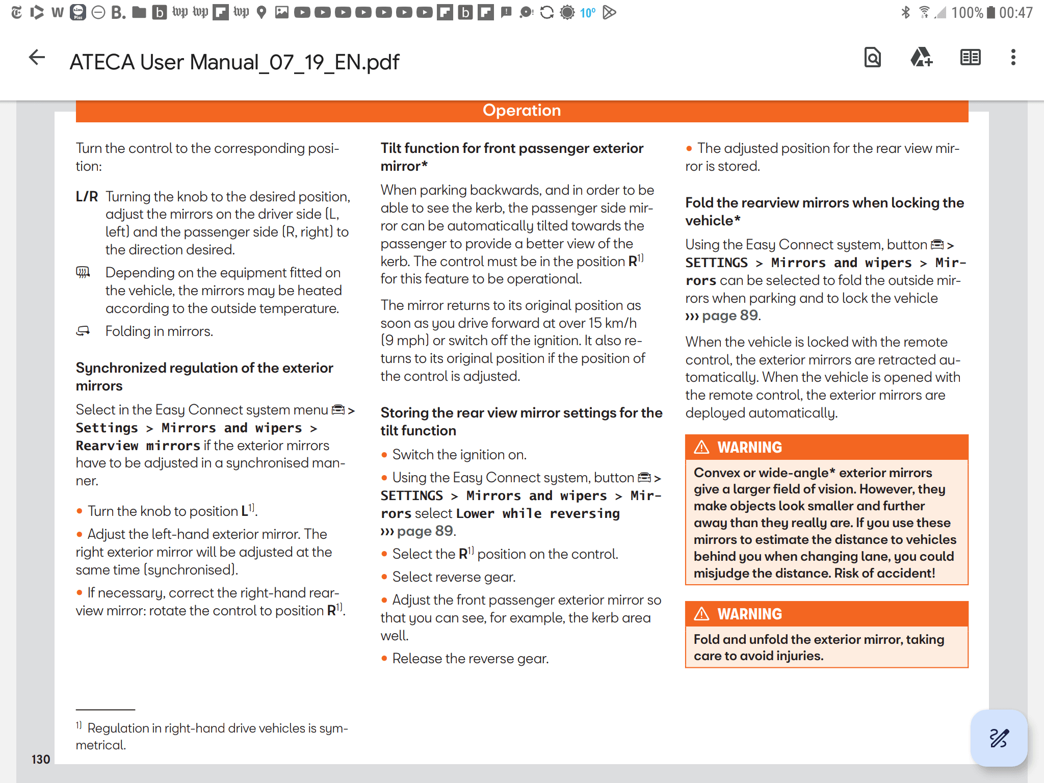

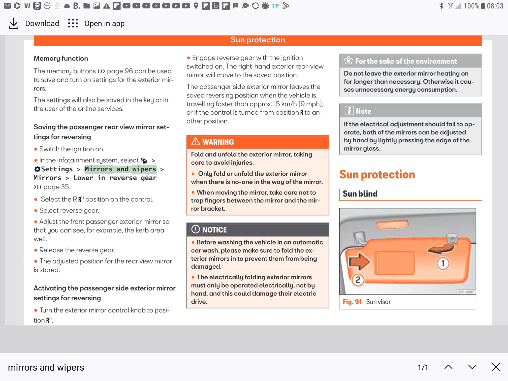

Hi Guys, I’ve just got a 73 plate Ateca (yesterday) and everything is great apart from the folding wing mirrors.
I just can’t seem to get them to work when I lock the car.
They work fine from the manual controls inside the car.
I’ve searched on here and it seems that I just have to keep my finger on the lock button on the fob. But it doesn’t work.
I’ve tried pressing it twice and still nothing.
I’ve tried with the manual set to L, R and 0 but none work.
Is there a setting somewhere? If so, how do I access it?
Thank you
