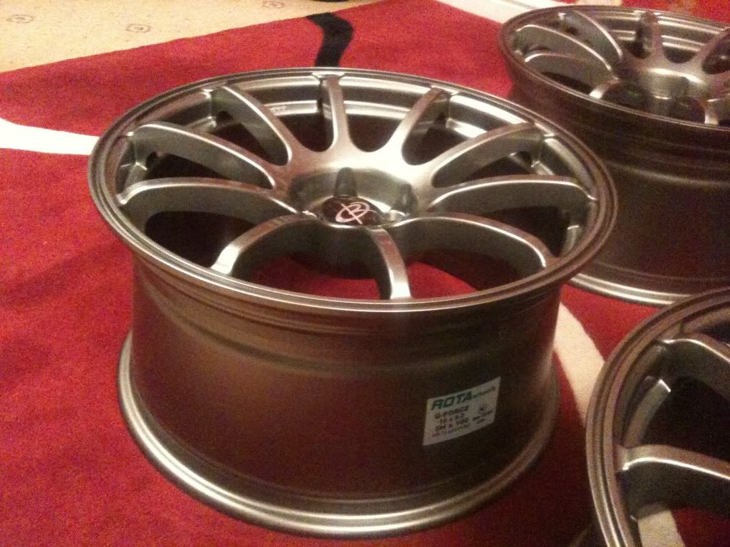

Here's the state of boxes I had to cram into the car without using bootspace (sub)
The top box is a 225!! :)
And here they are!
I'll be testing them on the weekend for room in the arches, won't b able to afford tyres for a while :(

What J are they ?
They're 9j mate, couldn't brave the 9.5 in the end! Oh also, I'm right in thinking you tested your wheels on wood blocks right?!?! Starting to get worried about what to put between wheel and wood so I dont put all the pressure on one spot.

Don't think Leon arches can be rolled I have et38 on the rear of mine they didn't fit with a 8 mm spacer on the front , you going to need some serious stretch on those tyres to make them fit. I would say either a 215 or a 225

why?!?! Your rears fit a 9.5j with a 8 mil spacer, Your et is 38 so would only need 5 mill spacer for 9.5 and I'm only 9? What have I missed?

The rear has no spacer et38 and about 10mm clearance if that , the fronts are et23 8mm spacer the et38 on the front with the spacer catch on the coilover adjuster and caliper

Hmmmm.... Gutted, I'll have look tomoz I guess. Wanted 235s on there tbh as well but nvm. So if your offset is 23 with 8mill spacer ur lookin at ET15 so for me would be 20 mill spacer on a 9.5j. I found a website that told me how much these new wheels would poke out each side and it looked pretty even on both sides. So could I not guesstimate that I'd save about 10 mill Inside and out?! Is that completely stupid? I already know it's partly stupid.
