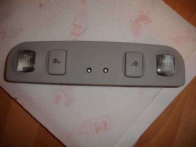

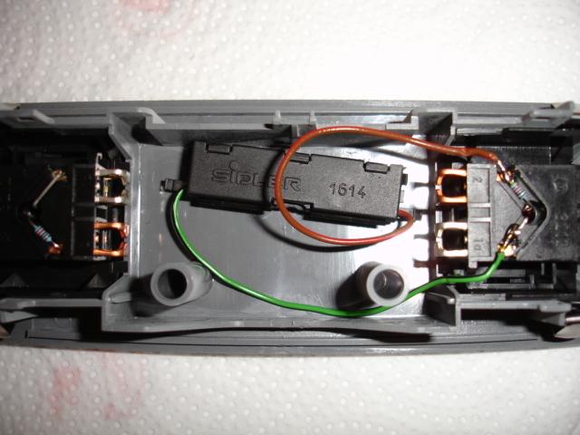

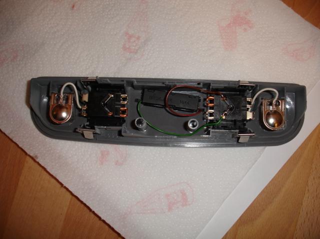

Have the light unit with ambient LED's above the back seat fitted today.
Drilled 2 holes of 3mm instead because I used the LED's of the ambient LED unit only and not the black plastic housing.
Distance between the 2 holes is 20mm and they're 15mm away from the edge.
Replaced the bulbs for the reading lights with LED's also.
Pictures:
Result:
